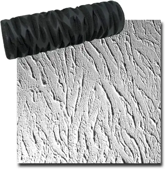

Repairing a crack in a garage wall and need to re-create the texture shown. Appreciate any help as Google was stumped.enter image description here

Looks like a Tree bark texture which is created with a drywall roller cover.
You might be able to find one of these covers at the big box hardware stores, if not, you can source them from similar online stores.
Image credit: Amazon treebark texture roller cover

  • Thank you! I also found the video below which is an alternate way to create that pattern. – patrick789 Aug 26 '23 at 20:47
  • https://www.youtube.com/watch?v=YBlph6um9aY – patrick789 Aug 26 '23 at 20:47
    I think the follow-up question should be "How you you make a the new tree-bark match the original?" – RonJohn Aug 27 '23 at 22:05
    @RonJohn easy - you tear it all off and redo an entire wall with the same roller. Might have to do the entire room. Or you buy a tall piece of furniture to hide the repair :) – Criggie Aug 27 '23 at 22:39
