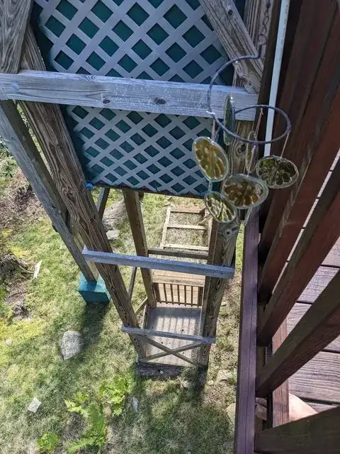

We recently acquired a house that has an elevator-like mechanism. The former owners call the thing a "dumb waiter", suggesting that it's not safe for human use. Although it's roomy enough for a human to stand in, and supposedly has a 300lb capacity, I certainly wouldn't ride in it. (Amusingly, one of our new neighbors, friend of the former owners, says he's ridden in it; but, he's a retired jockey :-) ).
I'm wondering if there's any possibility of upgrading the thing so that it is safe for human use. I don't think it'd be possible to install a braking mechanism, like the one on a real elevator. Absent any other ideas, I think the solution would have to be some sort of redundant suspension mechanism.

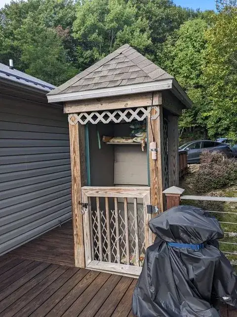

This is probably a situation where a picture is worth a thousand words, so here's a few. The "shaft" is composed of 6x6 timbers at each corner. The "car" is about 3-feet square and is made of metal; little plastic wheels keep it rolling along the timbers. It's suspended by a small electric motor and a length of 1/4" wire rope. The overall floor-to-floor height is 18 feet.

    this is going to involve figuring out where the weak points are on that thing and reinforcing them to your satisfaction. This may involve getting a structural engineer involved. And getting a control panel inside the cabin. – ratchet freak Aug 29 '23 at 07:57
    Never mind an elevator, that's not even safe as a dumbwaiter. It's pretty hopeless but fully enclose the shaft, replace the gates with doors and put interlocks on the doors so they can't be open when the car isn't there ... This won't make it safe but would at least protect bystanders a little. – jay613 Aug 29 '23 at 08:03

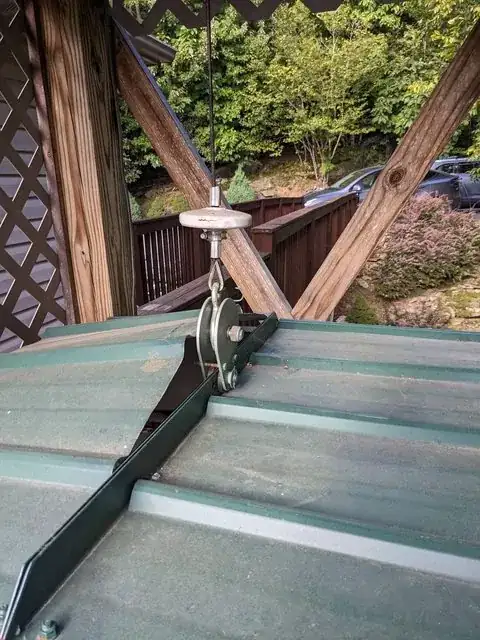

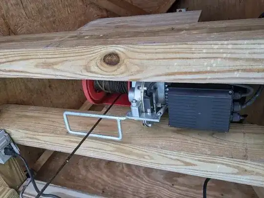

    My assumption is that the winch has the 300lb capacity. Everything else (including the connection of the winch to the frame) is a crapshoot. That connection to the roof of the "car" terrifies me. – Michael Richardson Aug 30 '23 at 18:40

No, it can't. The design presupposes that it is only going to be used for food. It will not be robust enough or safe enough for people. Unsafe meaning, collapsing and falling down or just people poking their fingers and arms where they will snap.

Forget it, this thing is a complete pile of junk.
But don't take my word on it. Ask your insurance company, because I guarantee this thing is news to them.
To qualify as a human-rated elevator it needs to be designed properly from the ground up. And in commercial practicality, that means using an off-the-shelf pre-engineered design, because that is far cheaper than a civil engineer designing an elevator from scratch. It would be impossible to build an elevator shaft out of 6x6 and have it be safety rated. Using a winch as a lifting mechanism (and braking mechanism!!!) is also a non-starter
This was a foolish hack design done by the previous homeowner behind the back of his insurance company. They represented it as a dumbwaiter for cargo only, even though it's obviously built for humans, for liability reasons.
There will be no way to adapt this into a legal elevator. For your own liability's sake you should either demolish the whole thing, or redesign the car to be 2 feet tall to preclude use by humans, so it truly is a dumbwaiter.

    @supercat, the requirements for a material hoist are approximately 300 pages long. Just to give one failing: "7.5.1.2.2 Each door or gate shall be equipped with a contact that will prevent operation of the driving machine, unless the door or gate panel(s) is in the closed position as defined in 2.14.4.11." – Mark Sep 01 '23 at 00:17

There's arguably no way to make this safe
There's two bits for this: making it safe enough for an insurance company, which you can't do, because you aren't a licenced engineer, designing from a list of pre tested and approved systems.
But there's also making it safe from your perspective - i.e, turning this into less of a deathtrap. I'd argue this can't be done without a rebuild, either.
My big worry is that the elevator car sticks and slips somewhere. It gets caught on the platform, the cable spools a little, and it drops a little way. The winch that is fine under just a standard load suddenly has the job of bringing an elevator car to a near instantaneous stop.

If you're determined to make use of this device for moving humans, a secondary support system should be created. On the expensive side of things, I envision a series of nested cylinders containing hydraulic fluid. As the chamber descends, the fluid is pushed into a reservoir through a flow regulating valve. This would mean that a cable break would turn the free falling chamber into a carefully controlled descent.
Alternatively, a cable of similar strength as the winch wrapped around a capstan which is in turn attached to an unsightly large air-paddle would accomplish the same thing at a lower cost. Provision would have to be made to reel in the cable as the chamber ascends as well as allowing it to spool out on the descent. The air-paddle would only come into play if the primary lift cable breaks.
