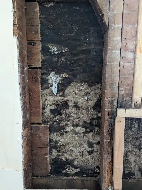

Dry rot was found inside an exterior stucco wall, water entered through holes from rusted-out bolts that were holding up some fake shutters and trim board. 2 studs about ~1 foot and a third stud ~2 feet, along with adjacent wood sheathing are affected. The studs, redwood, are not completely rotted out, so they were sistered with new wood. Sheathing was cut back to remove as much rot as feasible. The tar paper between the stucco and sheathing, in affected area has disintegrated. During initial construction the stucco wire was probably attached to the sheathing through the tar paper. No insulation present, nor will any be installed. The original interior wall is lathe & plaster, but the repaired section will be closed up with drywall.
Building is in SF Bay, wall is south facing, so it does get exposure to heavy rainfall during some years.
Looking for an answer on if & how-to re-waterproof this exterior wall now that the tar paper gone in affected area (3 stud bays, 1-2 feet each bay). The work so far has been performed from the inside, so I am looking at the back of the stucco, with nails and wire sticking out -- new tar paper would just get shredded during install process.
I would really like to avoid replacing the stucco just to install new tar paper -- especially since the work area is second floor of building and the stucco is at max strength (~100 years old). The exterior stucco has been painted a few times. What about sealing the exterior stucco? either just the stucco without tar paper? or the section of wall inclusive of the offending bolt holes (~40 sqft)? What would be the correct type of sealer product?

overall view sheathing cut away, tar paper rotted away

  • So basically, *does stucco require tar paper behind it other than to install it in the first place* and *what to use to keep stucco in working order*. The rot remediation doesn't have anything to do with it, other than it might not be properly hung anymore on enough supports. Pictures would help. – Mazura Sep 10 '23 at 22:49
  • 1) Sorry no pictures until tomorrow. 2) Yes the question is really about preventing future water damage to the wood framing. Is sound stucco with normal exterior latex paint sufficient? or should I do more? 3) With some of the sheathing gone, you are right that the stucco is no longer "properly" hung. However the biggest area is about 1 foot within a single stud bay, so I was not that concerned, especially since this is a second story and there will be minimal chance of exterior impact. Are you suggesting I try to re-support the stucco? – SeriouslyStan Sep 10 '23 at 23:15
  • More supports? Not if you're not concerned; 1', meh. **Is sound stucco with normal exterior latex paint sufficient? or should I do more?** +1 – Mazura Sep 11 '23 at 16:00
