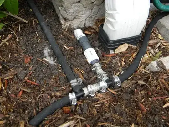

That looks like a very flimsy coupling, as it barely has anything to hang on to. Better to use a regular PVC barbed coupling, which looks like this:
Usually you use a stainless steel clamp around the connections:
With bigger/thicker pipe, you sometimes need to heat the pipe using a torch slightly -- just get it a bit pliable so you can get the fitting in, but not "melty".
Here's a finished connection (using "white stripe" 75psi poly - in this case as a non-pressurized drain line):
Here's another example showing connections to soaker hoses:
gregmac
  • 28,910
  • 84
    Aaron wants to use a 1/8" soaker hose. Your recommendation is not applicable. – Philip Ngai Apr 16 '15 at 16:17
  • @PhilipNgai The OP stated the leak is in the connection to the regular poly. There's also no reason a soaker hose couldn't be connected the same way, and in fact a couple seconds of searching finds an example (added to my answer). The tiny little barb fitting pictured in the question is simply not going to work well. – gregmac Apr 17 '15 at 01:47
