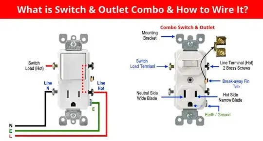

The insulation for the bottom wire is touching the conductor. This isn't up to code in some places. Re-strip that wire so that the insulation starts over the blue plastic, and the wire wraps around the screw.
Ensure the wire is securely underneath the screw if you are using this method. The red curve shows the area where stripped wire should be located, and the red circle shows where the insulation should not be touching the conductor.
Outlet Image with Circled Area and Wire Example
