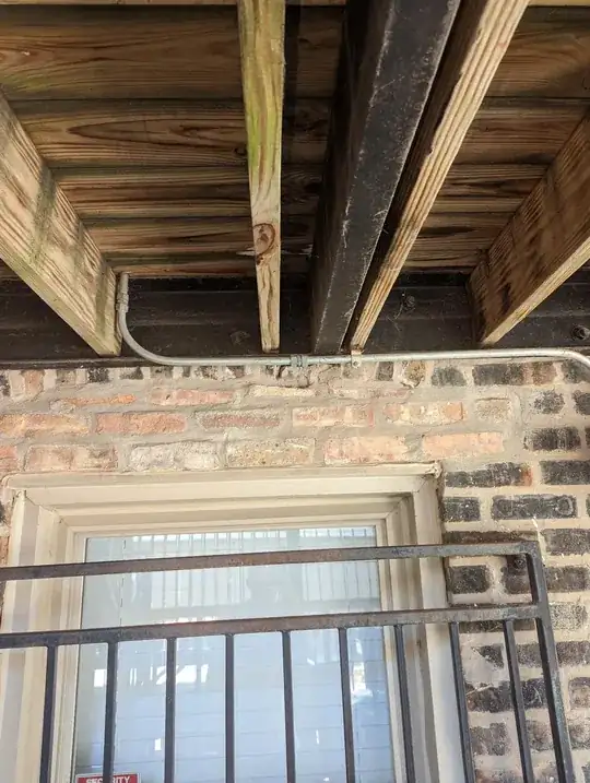

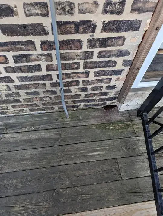

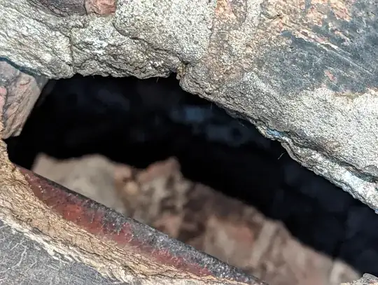

What materials do I need to fill this hole on my 2nd floor balcony? It's deeper than it looks. There's nothing for bondo or caulk to adhere to do not sure how to create a backing.

That looks like a brick fell out or in, and critter(s) have been using it for access to the building. Can you get a picture from under the deck? – Triplefault Sep 23 '23 at 16:46
Thanks for fast response. Just uploaded new photos. – FalcoBalco Sep 23 '23 at 17:50

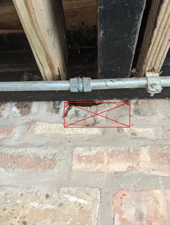

Looks like some bricks fell out (or in?). A mason or a DIY mason could put the bricks back in, perhaps.
A possibility: Try taking out the schmutz X'd out here:
Then see about either adding bricks from below (can a mason do bricks upside down?) or fill the hole with some pressure-treated wood or plywood.
