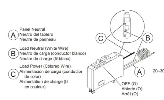

The main panel is the one place where ground and neutral wires can go together on the neutral bar. However, when you connect a GFCI breaker (and possibly an AFCI breaker) it needs to have neutral go to the breaker first. Then neutral goes from the breaker to the neutral bar with the pigtail. Many panels have "plug on neutral" to simplify this process, but yours does not.
To connect a GFCI breaker:
  • Hot from circuit to breaker (as always)
  • Neutral from circuit to breaker (there should be a clear place for it)
  • Ground from circuit to neutral bar
  • Neutral pigtail from breaker to neutral bar

The pigtail from the breaker isn't the problem; the neutral wire from the circuit almost certainly is. Those are incorrect as shown (grounds can share a screw on the bar - neutrals cannot - neutrals are "one wire per hole," whether a pigtail from a breaker or direct from a circuit - that's a code issue, though, not a functional one, but it needs to be corrected) but the functional problem is circuit neutrals don't go to that bar at all with a GFCI breaker. Only the pigtail does.
image from breaker instructions showing connections
Image source https://download.schneider-electric.com/files?p_enDocType=Instruction+sheet&p_File_Name=48840-088-01.pdf&p_Doc_Ref=48840-088-01 because that's the correct breaker for this panel.
