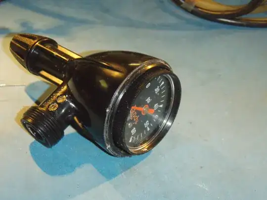

UPDATED: @mikes had the right answer - swap the thing out. I ended up swapping out the whole unit, as I had no idea how to (non-destructively) get it apart. Someone else might like to know how to disassemble the thing in order to get at the actual pressure gauge itself:
  • Remove the trim ring. I found a notch on the bottom and pried with a screwdriver Ring removed

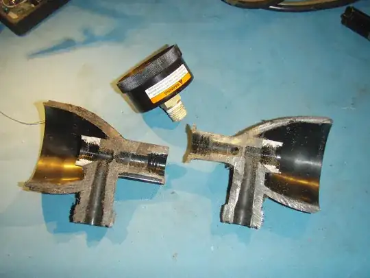

  • Unscrew the pressure gauge. It's normally threaded, however whatever they used as a sealant didn't want to let go for me. Excessive force may be required. Because I wasn't sure of what I was looking at, and thought perhaps it was formed in place somehow, I ended up cutting the thing in half to find out. Cut apart
Thus, we can see that as long as you can manage to get enough force on it to unscrew the pressure gauge, it should be possible to replace JUST the gauge portion, instead of the entire unit as I have done.
