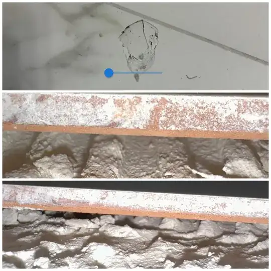

We hired a contractor to do redo our tile. One had to be replaced because it caved inward when a tool was dropped on it. We peeked under the adjacent tiles and there are giant areas without mortar. How much air under the tile is acceptable?

    Finally somebody puts an object in their close up photo for scale, but I have no idea what that thing is. Sad trombone. – popham Oct 13 '23 at 19:09
    That's not a "thing". It's a virtual zoom slider on the phone from which the screen grab was taken. The grout line is a decent reference. Size doesn't much matter, though--that sort of collapse indicates a void that shouldn't be there. – isherwood Oct 13 '23 at 19:23
  • Kinda looks like the subfloor isn't flat. – Huesmann Oct 14 '23 at 13:59
How much air under the tile is acceptable? Virtually none.
Tile installers use notched trowels for a very specific reason: To allow the mortar to make consistent, supportive and bonding contact with the entire tile. This only works if the mortar was mixed properly and the trowel is used properly. It looks to me like the former is the problem here.
See how the mortar in your photo looks like it slumped, and how it's somewhat smooth with protruding bumps? This tells me that it was overwatered. It was too loose when applied. Therefore it sagged and failed to make good contact with the tile. This happens when an installer is in a rush and wants the mortar to be easy to spread, or when they were simply careless with mix ratio, or when the mortar was retempered--rewatered to extend its working time.
It could also be that too small a notch was used. Very large tiles--those over about 12"--require a larger notch to give the mortar more fluidity under the tile. ¼" x ⅜" or even up to ½" notches are common. Here we see what looks like a ¼" x ¼" notch, or a ¼" by ⅜" notch where the trowel was laid over too far, shortening the mortar ridge height.
If you have more than a very occasional failure like we see here, you have contractual negligence, in my opinion. You should expect repair at no cost to you.
  • It could also be that the floor in that area was not flat, and the contractor was hoping that the tile would level it out "well enough" that the lack of a smooth floor underlayment wouldn't be noticed after the tile was laid. – Milwrdfan Oct 13 '23 at 20:46
  • But was too much water in the thinset the issue? Uncollapsed ridges plus the retempering suggests to me that the thinset got away from him. A water sucking backer board like Durock could have contributed. (You already got my vote, though.) – popham Oct 13 '23 at 22:47
    Looks too dry with no slump. Didn't know how to *set* tile or didn't care; have to wiggle it and hit it with a mallet. – Mazura Oct 14 '23 at 05:17
    No--dry mortar tears when it's troweled, leaving a jagged texture. We don't see that here. Doesn't much matter, but I'm reasonably sure this was over-watered. – isherwood Oct 16 '23 at 13:58

If those brown tile edges from your photo are from the same tile as the cratered tile, then you have ceramic tile. The TCNA Handbook specifies 80% coverage in dry areas and 95% coverage in wet areas, where "coverage" denotes the area of tile bonded with the underlying thinset. Those ridges in the thinset allow the air beneath the tile to escape as pressure and movement from above "collapse the ridges" during installation. Uncollapsed ridges is a strong signal of improper installation. In addition to @isherwood's criticisms, there's a possibility that the installer spread large areas of thinset all at once and that this thinset stiffened too much before he finally placed the tile. The backer board material can cause this stiffening by sucking the water out of the thinset.
