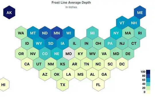

The type and method of water line insulation will depend on your location and the frost line.
Here it is shown in inches of depth needed.
frost line
source: Frost line
