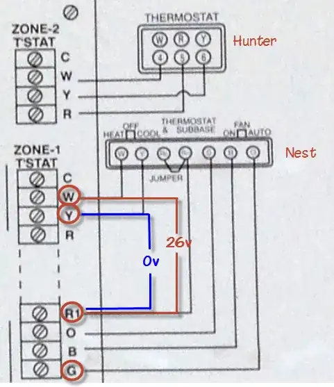

I put together the following diagram to describe the configuration:

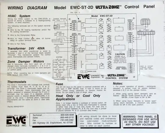

And here is a picture of the circuit diagram from the control board:

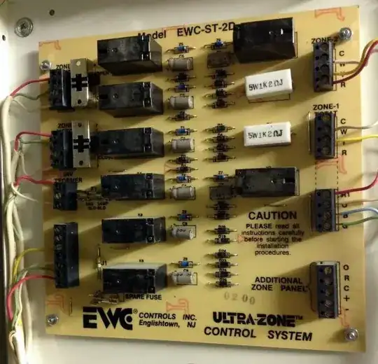

A picture of the control board:

Update: I disconnected all the wires on the thermostat side of the control board and tested with my multimeter again. Same result: R1 to W gives me 28 volts, and R1 to Y is 0 volts.

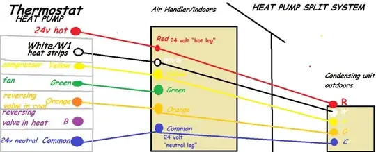

I have had a similar issue. I installed my first Nest Thermostat in January of 2017 and all was working fine. By June the AC would no longer work. I had a licensed HVAC technician come to my house and inspect my Electric HeatPump and furnace. Long story short the issue was the Nest Thermostat as the original Honeywell thermostat worked fine. I contacted Nest support first to verify that my HVAC system was compatible with the Nest Thermostat. Nest support verified that it was compatible. I then requested a warranty replacement nest thermostat. The warranty replacement device arrived and I contacted nest support a second time to verify that this thermostat was compatible with my system and to verify once again that I am connecting the wiring correctly. Nest support verified that my HVAC system was compatible and provided me with a picture of the wiring I should use. I connected the nest thermostat and tested. All was working fine. Yesterday 4/30/2018 I decide to turn on the AC because it is starting to warm up and found that once again the Nest thermostat will not operate the AC. This is very strange considering the nest operated the AC all summer of 2017 and ran the heat all winter of 2017 and into 2018. I replaced the nest with the original Honeywell thermostat and tested. Both AC and heat are now working.
So after two nest thermostats I guess the Nest Thermostat cannot handle electric heat pumps, despite what Nest support has to say.
