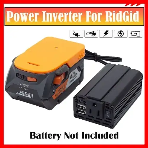

I am invested in the Ridgid 18v line of power tools so my answer is a bit biased towards my existing inventory.
I would get 2 or 3 pure sine-wave inverters, a few extension cords, and a few cheap-o clamp lamps with the aluminum reflectors.
Ridgid 18v pure sine-wave inverter
clamp lamp with aluminum reflector
