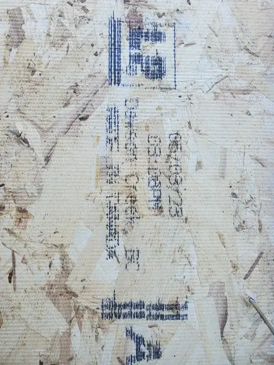

Is it safe (from water intrusion perspective mostly) to reuse newish LP siding?
My project is to basically re-sheath, wrap and reside 3 walls. On the largest wall I pulled off this siding which was made either 5 mar 2023 or 3 may 2023. Either way it's pretty new. It looks like it's in fantastic condition.

    If in good condition, use it. You probably can build a whole house with wood people throw out. The age usually does not matter, only the condition of the wood/siding/sheets. So made this year or 30 years ago it is usually still good to use. – crip659 Oct 18 '23 at 16:18

    @crip659, LP lost a class-action lawsuit over a siding product for big, big bucks back in the 90s. I think that may be why the OP mentioned LP and the panel age. Older realtors talk about LP siding like it's made of asbestos. – popham Oct 18 '23 at 18:53

    @popham Interesting. OP's picture looks like standard OSB sheeting. Unknown if the siding is on the other side. – crip659 Oct 18 '23 at 22:22
I see 2023 stamped on it, so yes, reuse it if its free of damage. If it was dated between 1985 to 1995, then I would do some additional research to verify that the particular product wasn't recalled by LP (they lost upwards of 1B USD in a class action lawsuit for a product manufactured between 1985 and 1995).
