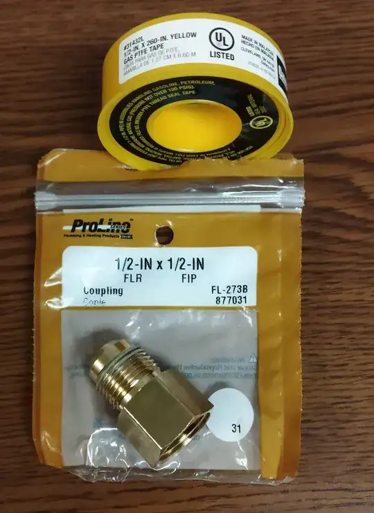

This 1/2" flare to 1/2" inch FIP coupler did the job. The dryer is happier than ever.
