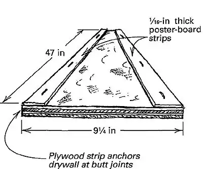

Horizontal: Pros will fit top piece to ceiling first and cutoff bottom piece for a 1/4 to 1/2 gap at floor. The tapered joint is easy to fill.
You can also get a tapered butt joint by hanging the butt ends between studs and using a floating backer with a depressed center area that forms the "butt taper". They are available commercially or can be homemade. This is the easiest way to get a "dead-flat" ceiling (or wall) when only the best will do.

    +1 for pointing out the butt joint depresser board concept. I've seen them used and do truly offer the opportinity for the flattest surface. – Michael Karas Jun 06 '13 at 19:46

  • A backer can be useful for creating a bevel joint, however. Take a flat piece, and then attach thing pieces to each side to form a wide 'U' shape. This will flex the butt joint into a bevel. (Edit: see the post @HerrBag for example) – DA01 Jun 06 '13 at 18:29
