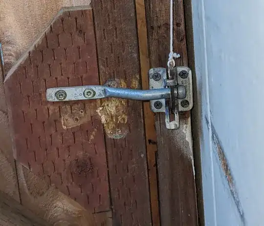

I bought a house which has a side fence gate with a latch scratching the side of the house. The damage was already there. It's not that bad, but I'd like to adjust the latch to prevent the damage from getting worse since the latch still scratches the house wall and thus continues to dig in.
Here is a picture of the latch:
Fence Gate with Latch Scrape
I think that the only way is to unscrew the latch and screw it back on "at the correct location". I think that's doable because it is currently too low anyway. However, I think that the screw on the right, for the latch to be at the correct location, would need to be in between the door pull and that small trapezoid addition. Here is another picture with a slightly different view:
Fence Gate Latch Flat View
I know that trying to use a location just a few millimeters away from an existing hole is not going to work. The only thing I can think of is that I'd have to replace the trapezoid part or at least move it to be able to do new holes.

Here is a picture of the fixed latch. I just unscrewed the whole thing and placed it straight. It doesn't wobble and doesn't scrape the wall anymore. I guess I was a bit scared by the way it was setup before with the latch and "latch holder" (totally useless addition!?).

    Try the tension cable, but sometimes those turn flat gates into tortilla shaped affairs. You can also move the entire latching mechanism up a bit and avoid the screw-hole-proximity problem. The real fix might be in resetting the hinge post or resizing (subtly) the gate. – Aloysius Defenestrate Oct 22 '23 at 18:18

  • I would take an angle grinder and cut the end off of the latch. I'd soften the corner around the edges, as I imagine that blob of material is there to prevent it from poking somebody in the chest or eye. I don't understand your weariness over the old screw holes. Rotating the latch flat and at the correct elevation would provide fresh material. Metal screw hole fabricated inconveniently? Drill another hole, but in a convenient spot. – popham Oct 23 '23 at 00:59

    Is that latch arm so far off level that you'd get plenty of fresh wood to screw it into just by making it level? – Andrew Morton Oct 23 '23 at 19:56

  • @AndrewMorton Yeah. For a quick fix, I'll do that. And as Kaddath says above, look at fixing the whole door at some point. – Alexis Wilke Oct 24 '23 at 19:01

Move the latch further away from the wall, of course…
Your 2nd picture shows you've a good ½" to play with, if not more. Fill the old holes with dowel & glue, to avoid proximity to the new holes being an issue.

Looking at the latch itself, it appears there is a little room to relocate the latch that does the rubbing, perhaps a 1/4" away from the wall from where it is now. It may need less to clear, it does appear there is about 1/2" to work with, but to move the latch less than a 1/4" will be difficult since the screws would try to go back in the old holes. The 1/4" back should get the screws into new wood, I would still fill the old holes with wood carved to fit the old holes, so the wood where the new screw locations are will be well backed up and last longer.

If you can't move the screws, for a quick but lasting fix, you could file or grind down the ball end on the latch. Take a few mm off the length, and smooth it over nicely to more of a ball shape.
But it might be preferable to move the screw holes anyway, if necessary by filling the existing holes so you can drill close to them. To fill outdoors I'd drill out for dowels, glued in with exterior wood glue, but a simpler approach is to use epoxy.

  • I'm not sure how difficult it would be to file the latch unless I remove it (I have a vise in the garage). I think I'll just try to move it. – Alexis Wilke Oct 24 '23 at 18:58
  • Fair enough. If the screws turn out to be a problem, I'd get a chair, sit on it with the gate held between my knees, and file it. Or use 2 sandbags to hold the gate, which is what I'd do if using the angle grinder – Chris H Oct 24 '23 at 19:15
