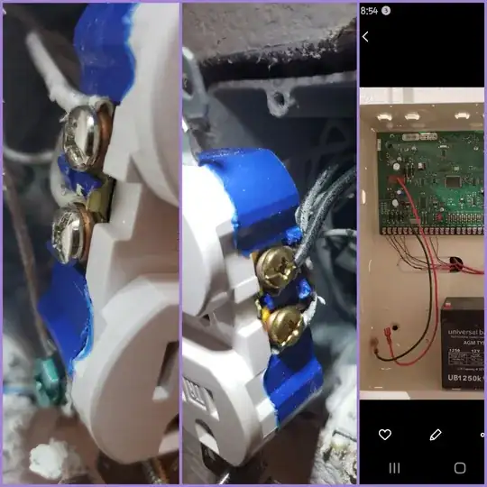

Thank you all!How do I disconnect the wires for home alarm located in AC outlet?
My system is not monitored. I reside in a townhome, built 2018. I called the company and she instructed me to disconnect the backup battery. Done.
Then she stated to locate AC and disconnect wires. There is an AC plug next to the panel in my master closet. I've removed the AC cover, but not sure which wires to disconnect.
My alarm will go off, stating battery trouble, here in about 10 minutes.
AC left, right and battery disconnected

    Pictures of your system with the panel open would allow pointing out specific items. Please [edit] some in using the sun and mountains icon above the edit box. – Ecnerwal Oct 24 '23 at 13:14

  • The transformer for the alarm power does not appear to be physically located at the outlet near the panel, per your pictures. – Ecnerwal Oct 24 '23 at 14:19
  • Thank you all!! I just removed the red wire, and it disconnected with no beeps or chirps. – Deirdre Oct 29 '23 at 18:27
Close your outlet box. You don't need to be in there. It's dangerous.
Disconnect "1". Fold the wire back and twist it over itself so the end remains far from the circuit board. This, and the disconnected battery, will shut the system up. This is not dangerous.
Then, trace "2". The other end will be at a power pack plugged in to a wall outlet, not inside the wall outlet. Find the other end and unplug it. It shouldn't be far from this alarm panel, but it may be in another room adjacent to, above or below it. To find it, start by just looking for a power pack plugged into a wall outlet with a red wire attached. You should be able to find it just by walking around. If not, try tugging on "2" and you may be able to hear or feel which way it goes.

Typically the panel opens to reveal the alarm system motherboard, a bunch of wires running to sensors, and a backup battery. The power supply is usually a plug-in transformer at low voltage (16VAC is typical) and the battery is generally a black plastic rectangular item at 12 VDC. The battery can be disconnected by pulling the connectors off the terminals, in almost all cases.
You can either replace the battery or just disconnect it if you don't want any of the alarm functions. If the sensors include smoke detectors and/or carbon monoxide detectors, you may want to replace the battery so those will continue to work, even if you don't want or use the security (break in - window/door and/or motion sensors) functions.
If you can't find the transformer itself, normally plugged in nearby, sometimes secured to the outlet with a screw to prevent inadvertent disconnection, you can identify the power supply wires at the motherboard and disconnect one, isolating it with a wirenut. As it's only 16V or so and power-limited, it's not hazardous to disconnect it live if it's difficult to find the transformer powering it.
Since there's no sign of the alarm transformer at the outlet near the alarm panel, it's presumably elsewhere. They are almost always plugged in. But you can simply disconnect the red wire on the left and isolate it, at least until you find that.
power supply connection to the alarm panel
