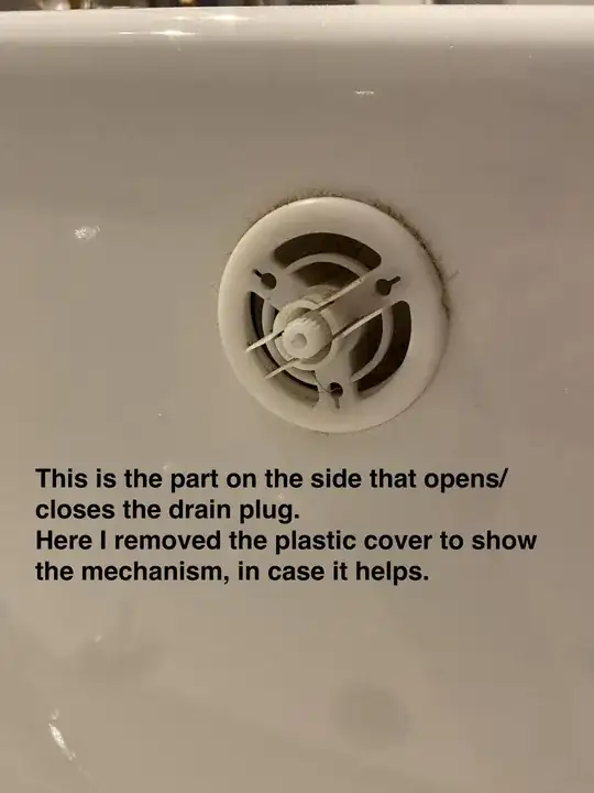

I just moved to a new flat and found out that the bathtub drain plug doesn't work well, so water leaves from the bathtub pretty quickly, even when it's "closed". I would like to know what to do to solve the issue.
Here are the facts I have gathered so far:
  • My bathtub is from the brand "Grohe" (and I live in Germany, FWIW).
  • There is a mechanism on the side that makes a small plastic part go up and down (when it goes up, it pushes the drain plug up to open it and when it goes down it just lets the drain plug "fall").
  • The joint on the drain plug doesn't look that bad (at least to my unexperienced eyes).
  • If I really push on the drain plug with my whole weight, the water indeed doesn't flow away.
What I'm a bit puzzled about:
  • If it's a problem with the joint, can I replace the joint alone or should I replace the whole drain plug? Can I buy generic parts or it needs to be the exact same reference?
  • Is it normal that the mechanism on the side to open/close the drain plug doesn't actually pull the drain plug down when closing it? In other words, is it expected that "only" gravity is enough?

  • Side note: this type of plug isn't pushed down by gravity alone. When the tub has water in it, the weight of all the water above it is pushing it down with considerable force (the wide disc on top exaggerates this effect). This design may not seal properly when the water level is extremely low. – bta Oct 25 '23 at 23:49
  • SOME similar designs DO pull the plug downwards, but many of them rely on some weird twisting or other 'correct assembly' for that to occur - is there any indication that this is the case with this one? – MikeB Oct 26 '23 at 14:09

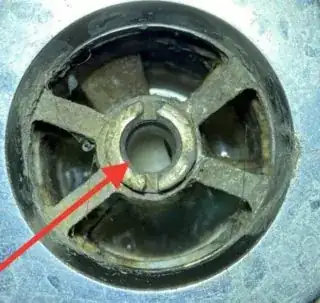

detail of drain
Given where that plug seals, cleaning all the crud from the sidewalls of the drain hole may be most of what's needed to make it seal properly. Particularly the built-up patch of gunk between 3 & 4 O'Clock would defeat the rubber seal and allow water to trickle past.

As already noted by Ecnerwal, the plug-hole is pretty cruddy too. That needs a clean up as well.
That type of plug has an adjustable 'drop'. In your case the screw/nut on the end - which unfortunately looks like it's already at its shortest.
With the plug out of the hole, drop the white lever mechanism to 'closed' ie dropped. Put a blob of something greasy & visible - like bright lipstick - on the end of the plug, where the screw is. Drop it in the hole. See if it marks the white lever.
If it does, then you're out of adjustment & it can't drop any further. They're wire-driven so you can always push them a bit more closed, as you mentioned.
You could try removing the adjustment screw entirely & see if that gains you enough extra drop to stop it leaking - yet still enough rise so it will empty properly. [There is the possibility of re-jigging this with a different screw… but that's going to be very fiddly to figure out which will fit but have a smaller head...

Start off by cleaning all that crap- which looks rather like plumber's silicone- off the chamfered mating surface of the metal portion in the bathtub.
Check that the central slotted piece is screwed in tightly. I fixed my leaky kitchen sink drain in this way, after finding that the whole plug/drain assembly was slightly loose and could move around, allowing water around the outside. Yours looks to be a similar design.
