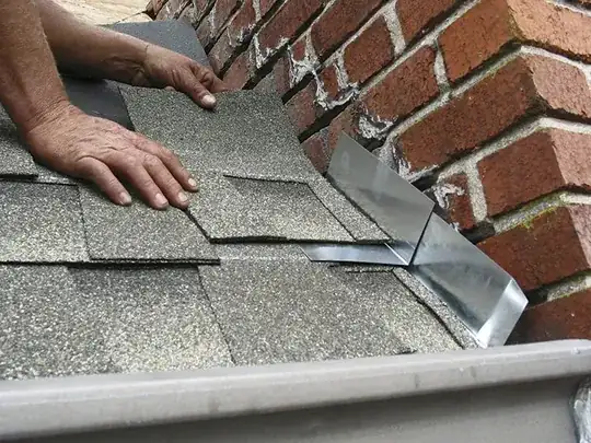

I'm judging by fuzzy photographs, but the flashing seems to have been done incorrectly. When done right, shingles and step flashing alternate such that any water running under one is still on top of the other. Here we see very large metal flashing laid completely over the shingles, so that any water running or blown under the metal encounters no further drain plane beyond the edge of the shingles.
Here's a diagram of where I'd have expected the shingles to overlay the metal (and lay under the flashing above):
Here's a good example of proper flashing:
There's also a diagram of the step flashing on that article.
I can't be sure this is the problem, and I'd hate to accuse your tradesperson of negligence, but that's where I'd start. Read and understand that article, then compare your situation.

  • I'm not 100%, but I actually think this is an example of not-great flashing. As far as I'm aware, long before shingles/tiles are involved, the flashing should be mortared into the brickwork (in the picture, you can see the pointing has been raked out, possibly to facilitate this, or possibly to remove the old flashing). Once the flashing has formed an absolute seal between brick and roof, then the shingles/tiles go over the top as pictured. Here's an example: https://verticalchimney.com/blog/chimney-flashing/ – Ralph Bolton Oct 31 '23 at 15:15
  • I get you now. The top of the step flashing isn't integrated with the chimney in the second photo. One way I've seen that done is to have a full-length flashing lap over them and which is cut into the chimney on a straight line. – isherwood Oct 31 '23 at 23:44
Isherwood is correct - this looks like very poor flashing. I would also add that the lead has not been well formed into the corner. If you are exposed to driving rain in high wind this would increase the chance of rain being blown under the flashing. It is also possible that if it has been built with very porous bricks, in prolonged very severe weather the bricks could be transmitting water through the wall. If that is the case a coat of weather-proofing should stop penetration.
