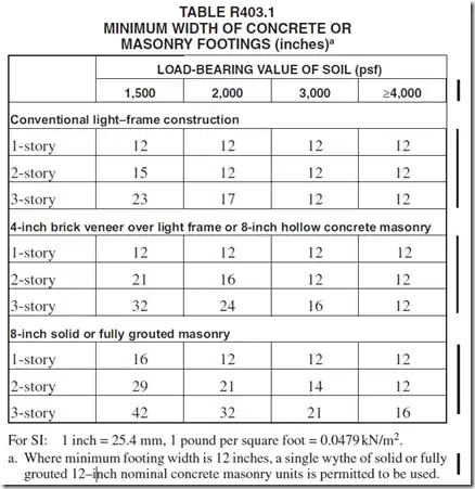

This chart can also help:
Baring looking the thickness up in a table (like this), most footings are between 6 to 16 inches max. A common rule of thumb is that the thickness of the footer should be as thick as the wall/post it supports. The commonly held belief here is that the load placed on the footing spreads out at a 45 degree angle within the concrete pad. So having a pad that is the same thickness as the post on top of it will allow all the weight to be distributed to the outer edges of the footer.
The IRC R403.1.1 states that “Spread footings shall be at least 6 inches (152mm) in thickness”. So that is the minimum. However, sometimes it is a good idea to make the footing to be a little thicker. Imagine a 16 sqInch footing with a 20,000 Lbs load carried by a 4x4. It is possible the weight bearing down on the 4x4 can shear through 6” of unreinforced concrete (we are pushing the psi rating of some concrete at this point).
