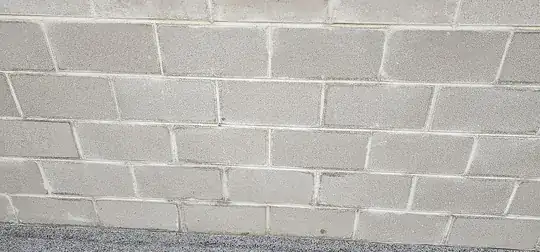

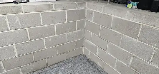

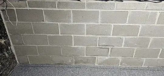

We moved in to a house two years ago that had a crawl space dug out and turned into an unfinished basement area several years prior (>10?). I was hoping to turn it into a home brewing room (planning on using a steam condenser mounted on my brew equipment to mitigate any steam), so I got the floor polyaspartic coated. A friend came over and recommended that I seal the surrounding cinder blocks/concrete - but I noticed dark areas around several parts of the blocks. Drylok recommends removing efflorescence - which I think there is a little bit of, but I'm not sure what to do with the darker areas.
Prior to getting the floor coated, I've never seen standing water in the area. When I was prepping to get the floor done, I moved a poster leaning against the blocks and noticed a 1" x ~3" patch of minor mold that was on the back of the cardboard backer of the poster (which has been leaning against the wall since we moved in). Temp/Humidity:
TL;DR - should I (and how) would you guys prep to seal the cinder block area?

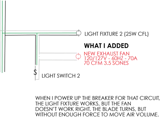

Whole "crawl space" enter image description here

It seems like you have a cinder block wall on the interior of your possibly poured concrete foundation? Did they do interior perimeter drain, do you have a sump? Are in you in a primary heating or cooling climate?

  • ok that's fairly low RH. do you have thermal camera or laser temp gun to see what temp of the dark areas are vs the lighter areas? – Fresh Codemonger Nov 09 '23 at 05:22
  • is the water drop just humidity or relative humidity? what is the temp w the drop icon? – Fresh Codemonger Nov 09 '23 at 05:36
  • You shouldn't be asking questions in your answer. Do that in comments on the question post _before_ you answer. – isherwood Nov 09 '23 at 14:22
  • I have a laser gun temp - i'll try to get some data tonight. The drop is relative humidity, drop + temp is dew point. – pete Nov 09 '23 at 16:54
  • no difference in temp between dark vs light – pete Nov 10 '23 at 20:25
