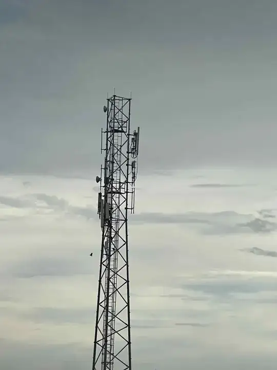

I'd like to protect my building from lightning strikes , Hence
neither building and electrical appliances nor people get impacted.
I can see there are two cell phone towers one is 400 metres south from my building and another one is 600 metres north from my building.
If I am not wrong both the towers are at-least 100 feet tall.
By norm all the mobile towers should have lightning arrestor.
Many of my neighbour's discouraged me saying that this cell phone towers should protect the near by 1 km radius.
My building comes in less than 1 km from both the towers.
Is it scientifically right ?
Shravan
