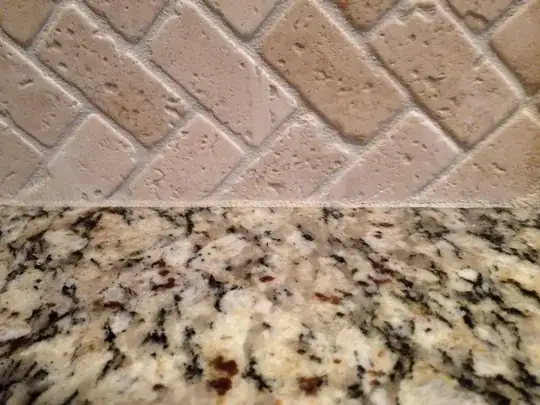

My kitchen has a stone backsplash and granite countertops. In some places there is a gap between the two, as illustrated below.
I would like to seal this gap to prevent moisture from getting behind the wall. Is a silcone-based kitchen caulk appropriate for this application? This backsplash was put in by the previous owner of the home and I am unfamiliar with the techniques and tools used to seal it. The areas that have no gap appear to have some sort of stone seal, like this:
Thanks for any help you can provide.

It looks like a sanded caulk. The big box stores have these in their tile areas. I would find something that matches your backsplash grout.
