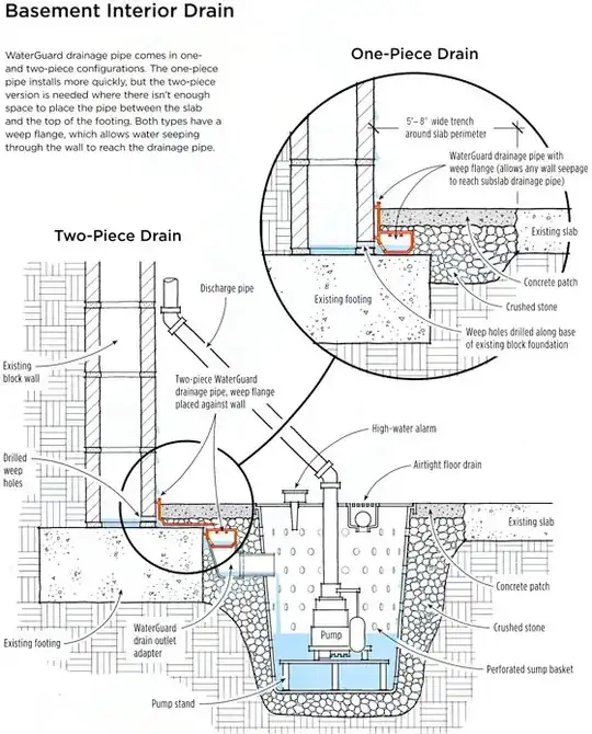

  • How does this system address sloping the drain to a sump? It appears that the 'drain tile' sits in a fixed position above the footer, meaning its level... – HerrBag Jul 10 '13 at 21:06
  • I was able to better help myself understand with a little more googling. While installing the drain on the footing, they actually drill holes every so often through the block to bring water to the drain. The sump is perforated as well, but this picture did help me. As far as sloping it TO the pump, I have no idea. I wondered that myself. I did some you-tubing and found some videos of them doing installs and the product working. I guess that's the magic part. – user13926 Jul 10 '13 at 21:20
  • I meant to post the link to the pic i found that helped me see how it will remove water around my house. Here it is: http://www.basementsystems.com/basement-waterproofing/basement-waterproofing-products/drainage-systems/waterguard.html – user13926 Jul 10 '13 at 21:21

  • @user13926 The 2 piece solution looks like a better solution, as it is deeper and looks to drain the slab better. Is it much more expensive than the 1 piece? – HerrBag Jul 10 '13 at 22:06
