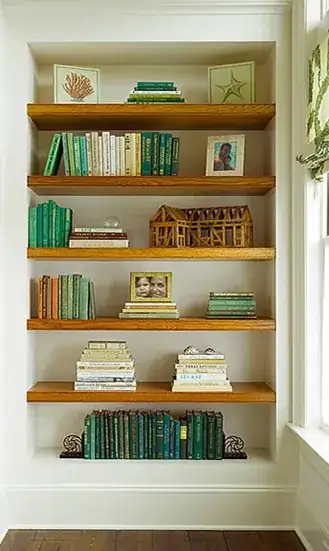

I have a bar nook area that I want to do something similar to the image below, but on the back of the shelves I want to put a large mirror. I was planning on ordering a custom cut mirror for the wall and then I want to install these floating shelves.
How do I get shelves without brackets showing on the sides? I also assume I can't put brackets that drill into the back of the wall because there will be a mirror there and it will crack.

You could mount support bars on the walls that touch the ends of the shelves. The bars should be screwed into studs that form the framing of the inset walls. Square tubing, either aluminum or steel would do well.
The shelves would need to be fairly thick. They would have a slot (dado) cut into in the middle of the end edges, slightly wider that the thickness of the support bars. The front edge of the shelf could have a strip of matching wood glued to its face, hiding the slot. The remaining edge of the shelf, especially the top edge, should be substantial, preferably at least 1/2"
blind shelf
An alternative would be to use an angle iron instead of a bar. This would allow a thinner slot.
A blind mounting system on the sides only would allow you to mirror the whole wall. This assumes that the span of the shelf is not too long and there is not too much weight on it. If the support bars (or angle irons) and shelves are solid, you probably could go up to 30" without too much problem
