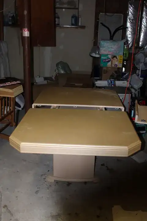

I have two identical 66" long tables with stationary pedestal bases. The table tops slide apart to accept one 24" leaf in the middle resulting in tables that are 90" long.
I'd like to modify one of the tables so that it expands beyond 90" to 170", and accept 3 additional leaves. In all, the 4 leaves will span 104".
What type of table sliders (rails) should I get and how should they be placed. How far apart should I place the pedestals?

Table top
Tapered corner

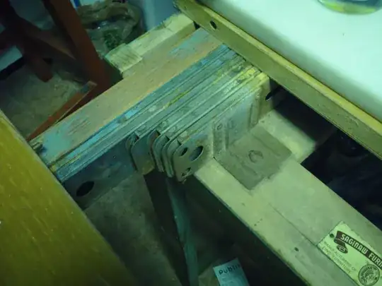

Equalized sliders

Short answer, vertical and strong. I have an old Saginaw Expand-o-Matic that opens from 24" to 90" and is designed to only use the end legs, no middle support. Not sure where you could find this hardware today though.
You want the sliders to be vertical because the majority of the stress will be vertical stress of the table and contents weight. It also helps load balance because you'll need more than one slider to more than double your expansion and positioned vertically, your contact points are all on the same level.
