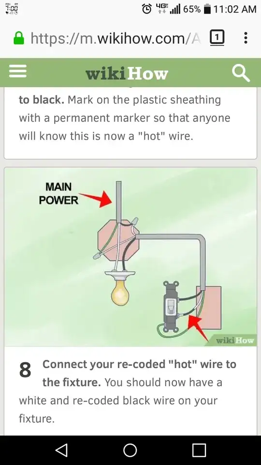

If I understand the question, you are asking how to wire a light fixture when the power is coming from the light box. I am assuming that you have no power coming from the switch.
The White (Nuetral) wire coming from the ceiling box power will go the the white wire of the light fixture (or silver screw if it has no white wire) The Black wire coming from the ceiling box power will tie to the white wire going down to the switch. Mark this white wire to indicate that it is now a power wire. The black wire coming from the switch will go the the black wire of the light fixture (or gold screw if it has no black wire)enter image description here
  • This is referred to as a switch loop, and is not code anymore. Switches need neutrals now, even if those neutrals are not used. As per the almost 5-year old [answer here](https://diy.stackexchange.com/a/30057/56531), wiring is done with a /3 cable instead of a /2 cable between the fixture and switch. – mmathis Jun 07 '18 at 19:45
