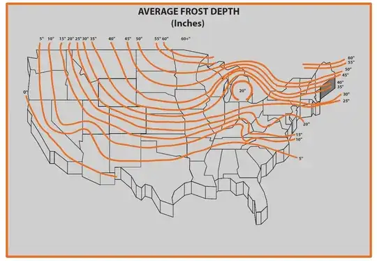

In general you can use these guidelines.
These are very good guidelines that are widely recognized. However if getting inspected I would just ask your building department for their code requirements.
**NOTE***** This is how deep your footings would be in undisturbed soil. So for example if there was a regrading of the land - as often the case in new builds - you would have to go this deep past the disturbed soil or consult an engineer that would sign off on something else. So if they regraded your land to 3 feet and you lived in Arkansas you would need to go to 54 inches or gets clearance from an engineer to put the footings shallower.

    What is the source/age of this data? It contradicts data I have seen elsewhere by a large margin in some areas. In SW Michigan, for example, this says 3 feet, whereas other sources give 4+ feet. – Necreaux Sep 20 '15 at 18:48
  • @Necreaux - This is the building code minimum. This is still current. A local county/municipality can obviously ask for more. – DMoore Sep 20 '15 at 20:53
This map showsFrost Line Depth the frost line depth for each state.
first1pass
    Hello, and welcome to Stack Exchange. This is very cool; what is the source? (Any clue why the frost is so much shallower on the Lower Peninsula of Michigan?) – Daniel Griscom Jul 14 '16 at 00:18
  • A similar map can be found here - http://www.decks.com/how-to/264/deck-footing-frost-depth-map – cwd Jul 17 '17 at 16:40
I say be mighty careful with vague national or even state line drawings of frost depth. Every county has those variations that have been recorded for some time and thus county records will show those zones that are hit hardest by extreme temperatures. This is especially true when extremes are wind driven into hillsides and when below 0 Fahrenheit air settles into valley floors for a week or more. This is exactly why seeking a professional who will apply the county zoning information to your exact location is vital.
