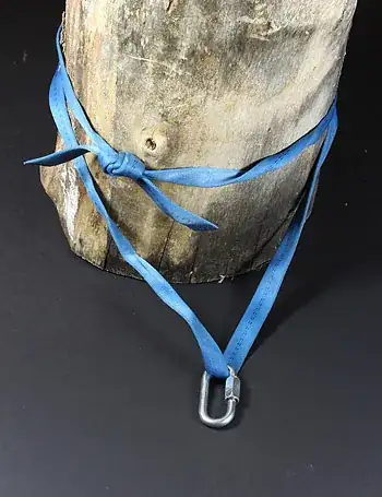

  2. Wrapping webbing around the chimney and anchoring to the webbing. This would be more difficult to install as I'd have to get around the entire chimney, and in the event that the entire chimney was not structurally sound, I risk the entire chimney coming down on top of me in the event I fell.
    Webbing around
    (source: canyoneeringusa.com)
Are there any other methods which I might have missed? If not, of these two which would be the safest?

An anchor system around the entire chimney is a much better option if properly placed. As you note, there is a risk of the entire chimney failing. This risk is difficult to assess, depending on the chimney's age, method of construction (reinforced?), type of brick, the mortar mix used, it's anchorage to adjacent structure, etc. The anchor should be placed as close to the highest chimney anchorage as possible, though it increases your fall distance, it decreases the bending moment in the structure.

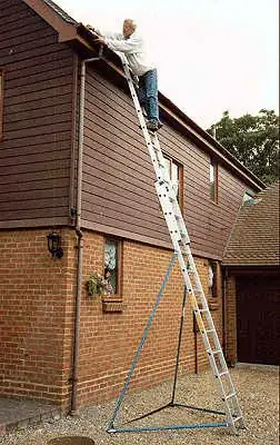

A suitable ladder stabiliser would provide a little extra extra security.
