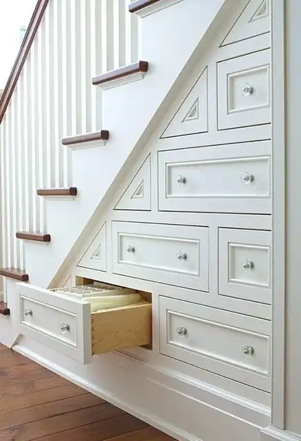

Another area I would like to use space is below the actual steps such as this:

    What is under your stairs? Dead space? I would put a small door in the wall for a small closet before I attempted a project as labor intensive as what you propose. Both of those pictures show stairs that were built with the drawers at the same time. A retrofit will be much more difficult. – longneck Aug 13 '13 at 17:56
    Agreed. If you have typical stair stringers, both of the images above wouldn't be possible without a major redesign of the structure. You could do something like this though, which sits below the stringers: http://media-cache-ec0.pinimg.com/736x/6c/1d/a6/6c1da680c304d75d21ed3d61f937a004.jpg – John Smith Aug 13 '13 at 18:01
    John's link is the only practical retrofit option. As longneck points out, the two photos above were engineered from the get-go for drawers. The John's example is essentially just building your own built-in in the empty space under the stairs. – DA01 Aug 13 '13 at 18:17

Image 1 is basically floating treads on the stringers and using the risers as faces of drawer fronts. As the comments reflect, this is easily done when building a staircase, but quite difficult to retrofit. It also won't work if your treads are wider and there is a stringer (or the need for a stringer) in the middle.
Image 2 is a hybrid. There are no stringers on the near face of the staircase in the area of the drawers, and none in the middle. There may be conventional stringers above that level. It appears that there are horizontal and lateral supports built around the drawers and supporting the treads in place of stringers. Again, something that can be done when building a staircase, but not practical as a retrofit.
Image 3, based on a comment by John Smith, leaves the staircase intact, preserves the supporting stringers and gives you flexible storage possibilities.
The weight of materials in the drawers is not really a consideration unless you plan to store gold bars or some other really heavy materials. The weight of people on the stairs is much greater than any strain from linens or even books.

I guess I don't see what the problem is. A stairway's structure is the stringers and treads. The rest—risers, sides, and underneath—is decoration.
The steps and stringers have to be strong enough to hold a lot of dynamic weight, typically thousands of pounds. Adding a few hundred pounds of static weight in drawers isn't going to be a problem unless there was one to begin with. Putting a cabinet underneath has nothing to do with anything.
