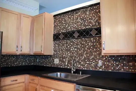

I just finished installing the backsplash in out kitchen using the mosaic glass tiles like you are describing.
alt text
I had no problems with putting the tile directly on the drywall using the usual thinset mortar you would use with ceramic tiles. I used a 1/8 in throwel with the little/thin tiles and the whole sheet of tile would attach pretty easy.
I think that whichever material you chose for the backing will work fine. If you can patch up and sand down the drywall to fix the imperfections, that should work also.
