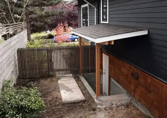

Three inches per hour! That's close to a lake being dropped on your house!
A gutter above the windows would help. So would an awning. Both have disadvantages, like limiting the light into the windows.
Does heavy rain occur frequently? Or is it just during, say, a hurricane? Maybe you could put a big tarp—supported like a tent over the west wall— during a storm?
A more permanent idea would be to extend the roof out and make a very deep eave.
Addendum:
Since this is the high open side of the house, extreme eaves might help and might look quite cool, but might introduce structural issues in the case of high winds.
What do you think of this kind of solution?: enter image description here
Of course it should extend well beyond the window wells and by putting it somewhat high, you could balance the amount of light between summer and winter, so that high summer sun puts the windows in shade and low winter sun streams right in.

  • This is a ranch and the roof faces N/S.. So the east and west end are just the peak ends. I build tille sheds over the window wells but when the rains come things seem to get overwelmed. Onve evry 2 years. I have two insurance claims so far. This one is on me – Scott Roy Aug 23 '13 at 21:22
  • @ScottRoy: I have amended my answer with another idea. – wallyk Aug 24 '13 at 02:33
