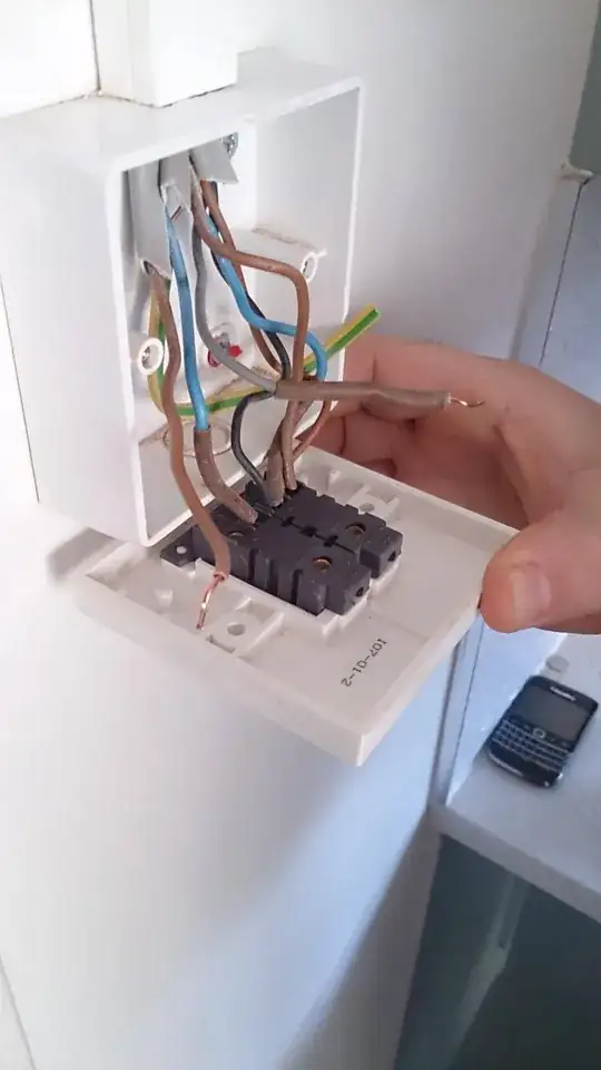

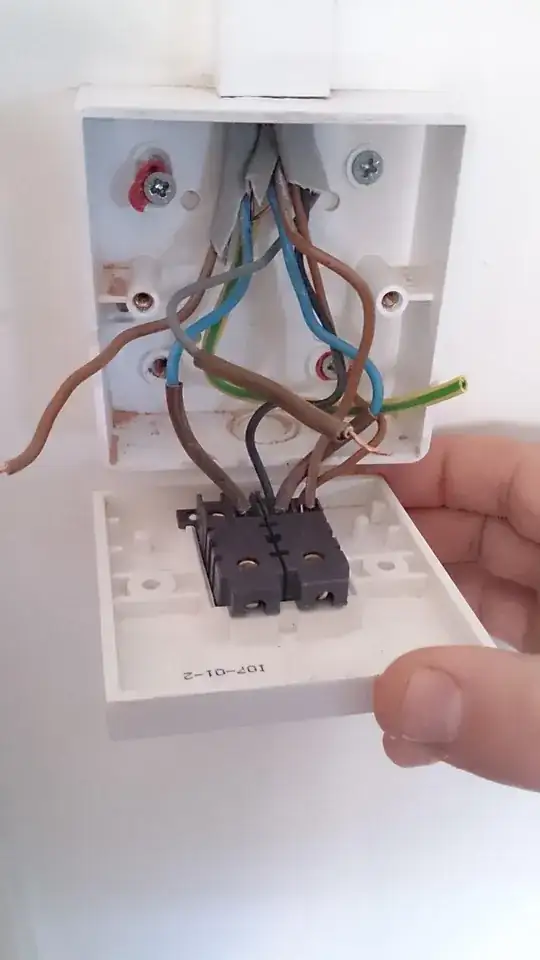

Here's my original light switch setup:
grey wire - brown sleeve was in the top right, brown wire in top left grey wire - brown sleeve was in the top right, brown wire in top left

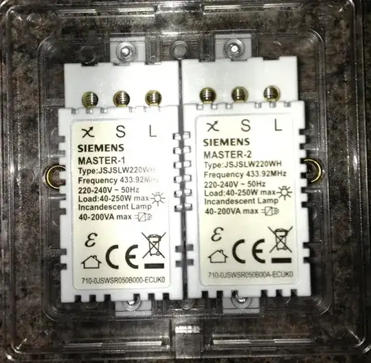

Here's the LightwaveRF:
I have tried many combinations without any luck, all outcomes results in one flickering light?
