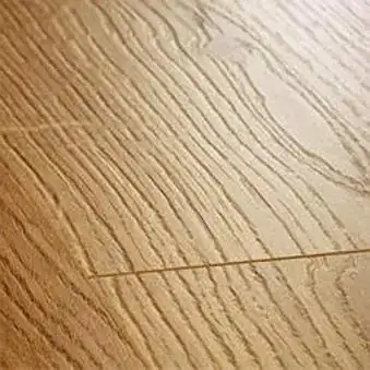

The most telling image—to me—is this one from here: enter image description here
The break in grain and the prominent joint is something I notice right off, but it is also something completely normal in natural wood flooring.
