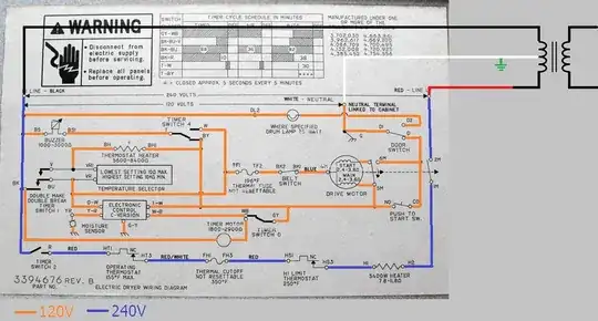

Here is a highlighted image of a random electric dryer schematic.
Random Electric Dryer Schematic
Click for larger view
Notice that all the control circuits are 120V components, and that basically only the heater is 240V. Extending this image further, we can see how the dryer connects to a 120/240V split-phase system using a 3 wire cord.
Random Electric Dryer Schematic attached to plug
Due to the nature of the 120/240V split-phase system, the grounded (neutral) and grounding conductors in a dedicated single appliance circuit are basically the same. The dryer will work just fine whether the N terminal is connected to a grounded (neutral) conductor, or a grounding conductor. However, connecting a NEMA 14-30R device in this way is nonstandard, and a code violation.

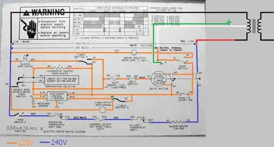

If a proper 4 wire cable existed, the schematic from above would look something like this...
Random Electric Dryer Schematic attached to 4-wire plug
