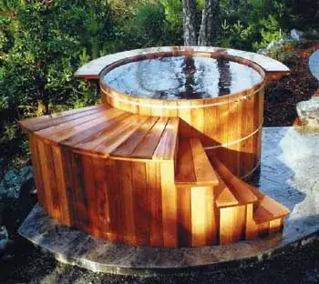

As others have pointed out, a square timber-framed hot tub is going to be a structural challenge. You're essentially building an above-ground pool--and you'll notice that they don't make above-ground pools in a square shape... mostly because it's nearly impossible to support the water along the long edges.
The solution is to go round. Then you can use steel banding to evenly support it all around. This is nothing new. Hot tubs have been made out of barrels for a long time. Google "barrel hot tub" for lots of examples. Modern versions use cedar slats.

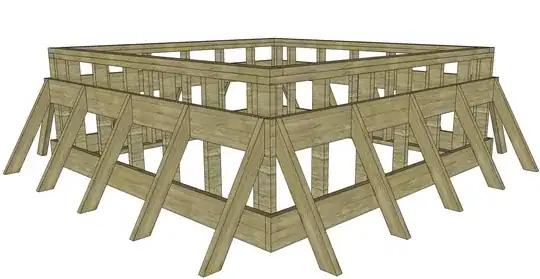

If you're simply framing up a hot tub.
Hot Tub Frame
It's not likely a structure like this will contain the water, since the water will not only be applying force downward, but also outward in all directions. Some form of banding would be a start to increasing the strength.
Hot Tub Frame with Banding
The banding may not be strong enough to overcome the forces, so bracing may also be required.
Hot Tub Frame with Banding and Bracing
I'm not sure of the number of bands or braces required (I'm no structural engineer), but overkill might be best in this instance.
Some Numbers
Model outside dimensions: 8' x 8' x 3'
Model inside dimensions: 89" x 89" x 36"
Model volume: 165.020917824 cubic feet ((89x89x36) x 0.000578704)
Amount of water held by model: 1234.521486241344 gallons (165.020917824 x 7.481)
Weight of water held by model: 10,297.3052722176 pounds*1 (165.020917824 x 62.4)
Pressure against sides: 0 psi at top, 1.302 psi at 3 ft depth, avg 0.652 psi for a total force of 1 ton against each side.
**1 Weight of water is force in the downward direction only, this is not the force pushing against the sides.*

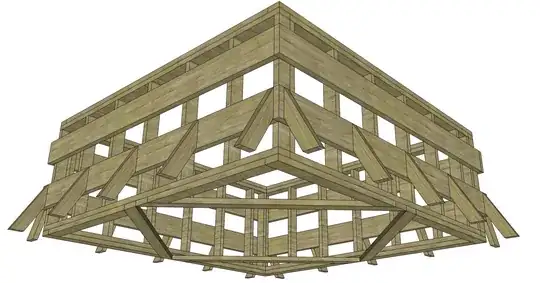

After a bit of research and a better understanding of the problem, I've come up with Lumber Framed Hot Tub™ V2.0
Notice I've moved the bracing lower, and added bracing on the bottom to add strength to the corners. Also notice the overlapping top and bottom plates, which should also add strength to the corners.
With the bracing, it has a total footprint of just under 9' 9" square.
  • The bracing would work if properly anchored. I'm still a bit concerned with the corners ripping apart. Maybe a hexagonal or octagonal shape with steel reinforced corners or wrapped in airplane cable would be better. – Chris Cudmore Sep 20 '13 at 14:12
  • Hmmmm, the banding isn't an issue. Being on a pad, the bracing is. And Chris is right, the corners are a concern. Hmmm... – Matt Taylor Sep 20 '13 at 15:42

    @ChrisCudmore That's why there'll be no Lumber Framed Hot Tub™ v3.0 – Tester101 Sep 20 '13 at 17:13
  • One suggested for anyone using LumberTub v2.0: I would rotate the band boards 90 degrees so they are flat. Overlap them at the ends and join with through-bolts. That aligns their stiffer axis to better support the outward force. It also provides a handy drink shelf. :) – Tim B Sep 21 '13 at 00:17
