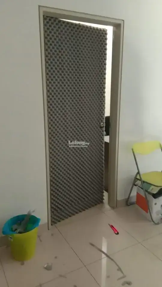

Because filling a hollow core door is difficult and risky (to the door), you could try to add the closed cell foam "egg crate" sound proofing to the inside surface.
JRaef
  • 14,844
  • 39
  • This can be a great way to substantially increase your risk of dying in a fire. https://en.wikipedia.org/wiki/The_Station_nightclub_fire – Ecnerwal Nov 09 '20 at 21:09
  • Most acoustic foam sold now is fire retardant. Don't use packing material though! – JRaef Nov 09 '20 at 21:18
