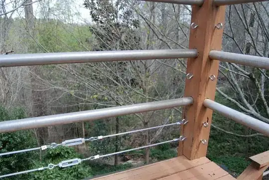

After more web surfing, I came across this blog post where they had the same idea I had--at least in terms of using off-the-shelf hardware:
Note the turnbuckles are almost closed, so even with one turnbuckle per-cable, a lot of slack needs to be taken out to make it taught. MIGHT Be doable with one cable on my short interior run, but anything bigger, I suppose it does make sense to go with one turnbuckle per cable.
That said, I personally think it looks great--but, admittedly, likely best as an outdoor solution on a large deck. It's probably a bit too 'industrial' for my interior short-run.
