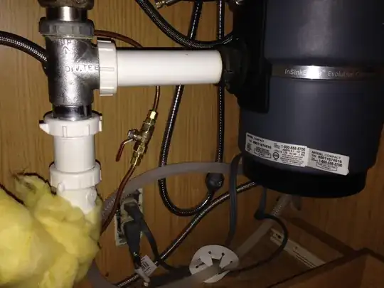

Here are some pictures of the hookup: enter image description here enter image description here enter image description here enter image description here

  • How is the dishwashers discharge connected to the plumbing (add a photo or two)? Did the plumbing change in any way from the old to the new dishwasher? How long is the discharge line? Do you have an air gap, or a high loop in the discharge line? Do you have a garburator? Have you recently made any other plumbing changes (new toilets, new bathrooms, etc.)? Are you noticing any sinks, toilets, or other plumbing fixtures draining slowly? – Tester101 Oct 02 '13 at 12:09
  • @Testey101 I added some photos. There is an air gap which is then hooked to the garbage disposal. No recent plumbing changes. – ahsteele Oct 03 '13 at 23:08
  • My first thought was the lack of a trap, too... and there's no SINK trap visible in the photos, but the dishwasher's discharge hose does make a significant loop, which acts as a trap. – TDHofstetter Aug 17 '14 at 18:21
