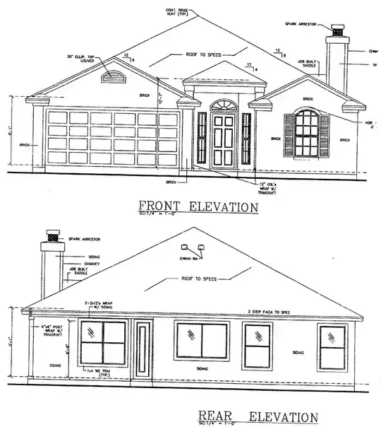

At my house in central Texas, where temperatures can persist at 86 - 110 degrees Fahrenheit, one side is always hot, no matter how long the A/C runs. That attic space is considerably hotter than other locations.
Attic ventilation includes:
  1. twenty-two 16x8 soffit vents
  2. two 10' runs of plastic ridge vent
  3. three stack vents
For better or worse, the ridge vents do not have a filter underneath and are covered with shingles.
According to the web, such as this website, 20' is the minimum requirement and the 22 soffit vents balance appropriately.
Will it help to install additional ridge and soffit vent? or will that disrupt current circulation?
UPDATE: The ridge vents are actually 8 ft. long (not 10') and only 5 ft. of that are actually exposed. 1.5 ft. on either side of the ridge vents are covered over by shingles.
house top view ridge vent photo house elevation

    Excellent diagram. It would help to have it labeled with North, prevailing summertime winds, indicate which side is always hot, and add any shade trees. You might also want to add an elevation diagram with windows for the hot side, and add info on the attic insulation and specs of your AC system. – mike Oct 04 '13 at 00:57

  • Prevailing winds are from the south in summer. No trees large enough for shade yet. Updated diagram with new info. Turns out the length of the ridge vents is only 8 ft. and only 5 ft of that is actually exposed. Assuming the roofer installed incorrectly.. – TugboatCaptain Oct 09 '13 at 19:38
    Given the height of the arched window, it looks like the 'hot room' might have vaulted ceilings, yes/no? If so, insulation in the ceiling might be filling the entire space between the ceiling sheet rock and the roof plywood, blocking passive circulation, rendering the soffit and ridge vents non-functional. In such situations, the insulation needs to be held away from the plywood by using baffles like the pink ones here: http://nyrampage.files.wordpress.com/2007/05/12-07-ceiling-insulation-007.jpg – mike Oct 10 '13 at 00:39

  • Another possibility is that the prevailing winds from the south are being diverted by south wing, such that they pass well above the north wing's ridge line. This would reduce the venturi effect, which acts to suck air out of the attic through the ridge vent. – mike Oct 10 '13 at 00:46
  • The hot room is not vaulted. The entire attic has ventilation baffles. None of the sofits are blocked with insulation. – TugboatCaptain Oct 11 '13 at 02:29
  • It's good to have those eliminated. I assume that the roof sheathing was cut back for the ridge vent. Another factor at play is that compared to the main house, the hot wing has a much larger surface area (walls+roof) per square foot of floor. The wing needs to be cooled based on it's thermal envelope rather than the room's square footage. – mike Oct 12 '13 at 02:08
