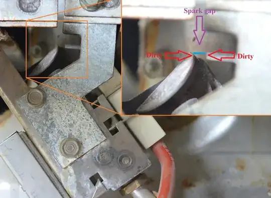

Dirty Gap
Next I took a closer look at the spark gap itself, and watched closely as the spark was generated. I even recorded the spark with my video camera, which allowed me to zoom in fairly close. This is when I noticed a bit of carbon buildup on the electrodes, and wondered if it could be that simple...
Cleaning the Gap
I grabbed a bit of 220 grit sandpaper, and cleaned the electrodes up a bit. steel wool is probably the tool of choice for this job, but I didn't happen to have any on hand at the moment (not yet unpacked).
Success!
After testing the pilot ignition a few times, the problem seems to be fixed. We had a cold night last night, and the furnace fired up fine all night. As I write this, the furnace has just cycled successfully yet again.

I found this YouTube video from Grayfurnaceman that describes the problem exactly, and says that the only solution is to replace the assembly. I'll be replacing the pilot assembly once the weather warms up, so we'll see if that solves the problem.

Things to know about the spark arc: The arc path will go thru the path of least resistance. Depending on its location, carbon soot can either increase or decrease the spark intensity and the “idealness” of the spark location. Because of this variability (i.e., unknown) that the carbon can present, it is best to have a generally clean surface. (Not looking for “clean” clean here but rather a “no soot, no noticeable carbon” clean.) It is important not to sand the thermocouple nor the spark electrode. They often have coatings that are resistant to oxidation. If the coating is sanded away then the part won’t last as long.
