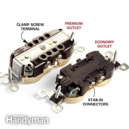

Besides an arcing switch, there are 2 other common 'loose wire' scenarios to consider.
  1. Loose wire wrapped around a side screw terminal. Turn off the breaker and tighten the screw. The wire should wrap under the screw head nearly 360 degrees (clock-wise). The insulation should cover the wire to within 1/8 inch or less.
  2. 'Back stab' connections are notorious for arcing connections. I cut them off (if there is sufficient spare wire and side wire them. The 2 round holes (in the right device) are the Quickwire connections (to be avoided) Much better are 'screw and clamp' devices that allow 2 secure connections per terminal (left device in photo) enter image description here

    While the images are outlets, the same principles apply to switches. – bib Oct 10 '13 at 11:54
  • Totally agree with 2! NEVER, have I ever, seen an electrician who doesn't want to come back to a simple job use stab-in connectors. – O'Mutt Oct 10 '13 at 12:53
  • They did use the quick-connect slots, where all the electrical work I've been around prior to my house has always been screw-wired. The main frustration I've had with stab-ins is they're a pain to take apart to change something, I've very limited experience with other problems. Could this just be the wiring connection used? I think I'll write up another question about screw connectors vs stab connectors... – Scivitri Oct 10 '13 at 17:46
  • There's no doubt the d@mn quickwire are faster, in the installation phase. There's just not enough contact area; if the device gets any stress in putting it back into the box, the connection can loosen. – HerrBag Oct 11 '13 at 11:44
