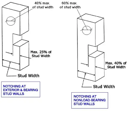

There are general guidelines for dealing with cuts in wood framing. For load bearing the basics are that you can notch 25% of the stud or 40% diameter for a hole.
enter image description here Note: Notches should not be square - this provides a weak point in the stud. Half circle your notches if you can.
Now there are ways around this if you need a bigger notch or hole. In my area local inspectors will let you double up the studs and go 35%S and 60% respectively on load bearing walls. This doubling up is a one time allowance - I couldn't do a whole wall like that.
For electricity these guidelines are more than enough to run several lines through a wall. For plumbing though you might need to use different width boards (frame wall with 2x6) or use structural bracing.
Note that in the picture you see both wall plates (which offer little structural support) and bracing around the plumbing cut-outs. When you buy bracing for plumbing there will be guidelines on the use of the product. Follow those to figure out hole and notch sizing.
For this instance: If I read right you need a pipe to run perpendicular to the studs. The same rule applies. I we are talking 2x4 construction that means that you have 1.5 inches going across. Mean you can notch 3/8" which isn't much. There are several ways to handle this is you have a larger pipe (a heater shouldn't need much though) needing out.

  • +1 for the reference. From my reading of the question, the OP wants to make a notch 100% of the width of a load bearing structure. That's just a bit over the 25% limit. I'm also more careful around doors and windows since there aren't adjacent studs to support the header. A notch there is the same as notching every stud above the header to the other side of the doorway. – BMitch Oct 11 '13 at 14:55
  • @BMitch - I didn't get exactly what they were asking. I just know that I had to buy braces that cost me $25 a piece for a plumbed wall that we couldn't turn to 2x6. The guidelines aren't exactly written well either. Reading them correct I would say that for jack/king that you are still held to 25/40%. I do not infer that you get the extra allotment since that is the required framing - not extra stud for support. – DMoore Oct 11 '13 at 15:00
