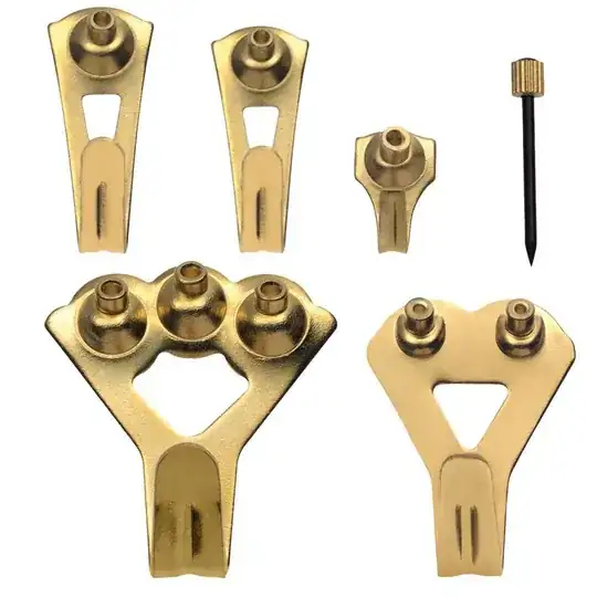

The picture should be hung using braided steel picture wire between the two D rings. Pictures need two support points to both spread the load and to allow a steady hang that does not swing.
I would strongly recommend Ook type hooks
ook
The heavy duty versions can support up to about 100 lbs.
If the surface is not as solid as drywall, consider using anchors with hooks attached. A discussion of various kinds of anchors can be found here.
