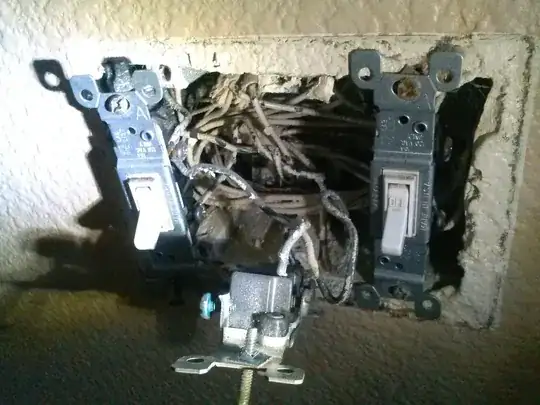

Edit: here's a photo of the switches box: enter image description here
and because it's really hard to see what's going on in there, here's a totally unprofessional diagram of the wires that are easy to trace/look relevant. The little boxes in the center of the switches on my diagram are the holes on the back of the switches, and the little boxes on the side of the switches are the screws. The yellow things are wirenuts and each has a ton of wires coming in and out and its hard to follow what goes where since everything is stuck together with paint. but it looks to me that the wire indicated in orange should go to the hole on the back of the middle switch and the wire indicated in red should be removed?
edit2: after loosening the screw terminal on the left switch it appears the orange and red wires in my diagram are actually a single wire that had an inch of the insulation stripped to wrap around the screw terminal. Would electrical tape adequate for replacing the missing insulation? Or does it need heat-shrink tubing or to be cut and covered with a wire-nut?

  • Also, can you (safely) get a picture of the cables in the box? – bib Oct 23 '13 at 22:51

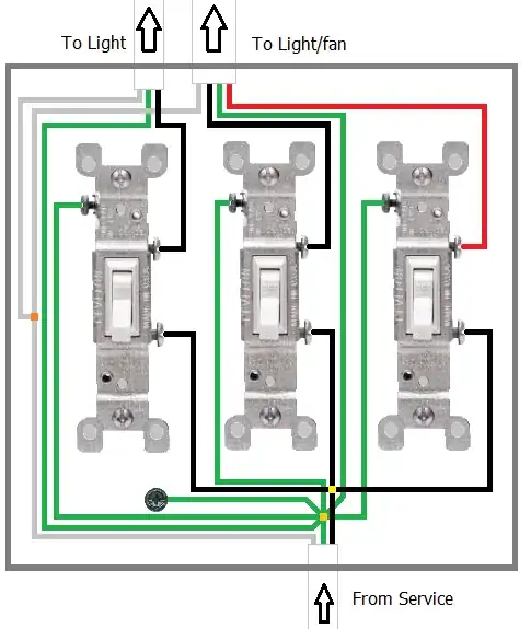

    The switches being "coupled" is a mistake somebody made, it is not a proper wiring technique. As for what the proper wiring should look like, see the first image in [this answer](http://diy.stackexchange.com/a/32803/33). More specifically, the proper wiring should look something like [this](http://i.imgur.com/Zti64xK.png) – Tester101 Oct 24 '13 at 16:30
  • I'm sure it probably wasn't a "proper" wiring technique, it was a hacky way someone changed the wiring to prevent running the lights without the fan. I've added diagram and photo to clarify – Jessica Brown Oct 24 '13 at 20:16
  • fwiw ... is the bathroom configured so that the ceiling light illuminates the shower? If so, I'm inclined to think that in the past, someone(s) in house was 'forgetting' to run the fan while using the shower, so the two were coupled, probably with an oops of coupling the fan to the mirror light rather than to the ceiling light. – mike Oct 24 '13 at 20:35
  • Since the red wire is short, you can probably slide the red insulation down to cover the gap, then tape/heatshrink the butt-joint. Code? not sure. – mike Oct 24 '13 at 21:59
This is what the wiring should look like...
Three Switch Wiring
Notice the incoming ungrounded (hot) conductor is spliced, to supply power to each switch. The ungrounded (hot) conductors from the fixtures, are connected to the other side of the switches. The grounded (neutral) conductor is spliced with the grounded (neutral) conductors leading to the fixtures, and all the grounding conductors are tied together and to the box (if it's a metal box).
IF you are positive the wiring was originally separate, 1 cable to the mirror light,and one cable to the ventilation fan, Then yes, you can uncouple the leads at the box where they originate. You are gonna have to identify which wires are "hot" and which wires are switched, you can do this with a simple voltmeter. The reason for this is that you Only want to separate the wires that feed your fan and your mirror light. You dont need to separate the Hots; The 2 switches are still gonna share the "hot", but only one switch will independently control each device. But if the light and fan have been hooked up together at another location, like in the junction box behind you mirror light, that is a different story.
