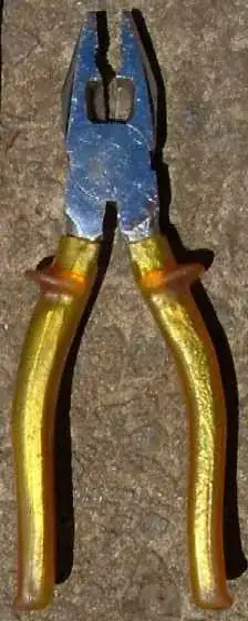

If you want to cut a live wire, try you can use a pair of insulated pliers. Every electrician (amateur or pro) should have a good pair of lineman's pliers. They can be used to strip wires and to tighten wire nuts, too. Lineman's Pliers

    I have a bunch of expensive Klien linesman pliers rendered useless after cutting through hot wires and melting big ole circles in the cutting blades. If you insist on working hot wires, keep one hand in your pocket and stay off metal ladders and concrete floors! – shirlock homes Dec 05 '10 at 20:29
