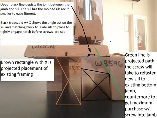

I added a edited pic that you posted earlier to show how the various parts will fit in their final position. The labeling on the pic should be self explanatory for the most part.
Some details that would not fit on the pic, the recut of the rib on the new sill needs to make the rib narrower by 1/8 inch, to keep it the same size will make it nearly impossible to get it to engage to matching groove in the jamb. I tried to set a sill to a window on the jobsite before the window was set, I could not get it to go in without a recut. Any slight bow in the sill would drive anybody crazy to get it to set. The rib is important to act as a water stop, so it really so stay intact, just a little narrower
Before all this is set in place and while this cutting is being done, make sure you get enough sill to use as test pieces, say 4 ft. extra, to make a number of 1 ft. test pieces. If it doesn't work mock up another.
Once all is going together properly, set the screws too, but do not caulk it yet, you must get it to fit first completely before you add caulk. When caulk is added between the sill and jamb to bed the sill, that will change everything enough to make it tough to reset the screws. I don't know why, it just does. I have done this stuff before and it is easy without the caulk, but as soon as caulk is added it gets really tough.
To get the angle of the screws to come out of the sill in the exact spot you need, start the drilling from the side the screw will come OUT of. This spot is in front of the rib and just passing by the inside corner of the sill out of the bottom of the sill. Where it comes out is not that important as long as it is outside of the stucco face. The most important thing is the sill is tight to the jamb with caulk in place and the screws have the least angle possible to draw the sill even tighter. enter image description here

  • Does the pic and the added text to the main body give you enough to go on for a while? The other window will most likely be different framing wise, but the main trick is to get the angle cut on the sill, the block/filler to match the same angle, and everything gauged/shimmed so that when the sill is slid into place, everything is snug – Jack Nov 14 '13 at 00:27
