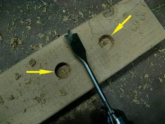

  1. Bolts, concrete fixing bolts, recessed, optionally plugged.
