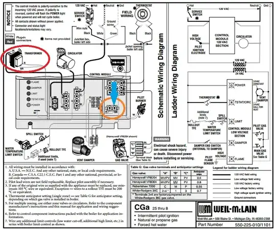

According to the CGa-010 wiring diagram, you'll want to connect the C wire for the thermostat to the terminal pointed to in this image.
Notice the transformer is circled in red. The location where the transformer wiring terminates is circled in orange. The "common" side of the transformers secondary is pointed to by a large blue arrow.

Is there any difference what transformer use for C in two-transformers system? I have independent boiler and A/C. I'm going to use boiler transformer to power termostat, but doubt if it could influence A/C. – Dmitriy Nov 12 '13 at 18:32
You'll use the same transformer that supplies the `R` wire to the thermostat. – Tester101 Nov 12 '13 at 18:33
Got it. I just realized that termostat doesn't have Rh, it has R and Rc. Sorry for bothering and thank you again. – Dmitriy Nov 13 '13 at 15:49
