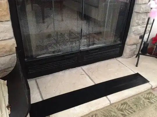

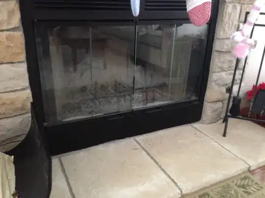

Similar to @BMitch's answer, I used a magnetic cover to cover the vent below my fireplace. We found this was the primary cool air leak for our fireplace and I bet it is yours too. It works great, and is very simple to remove before starting a fire. Since it is black like the fireplace, it is not even noticed. I bought one from this site selling the exact size I needed and in black.
With magnet on magnet removed and sitting in front
Here is my fireplace with it on and removed.
